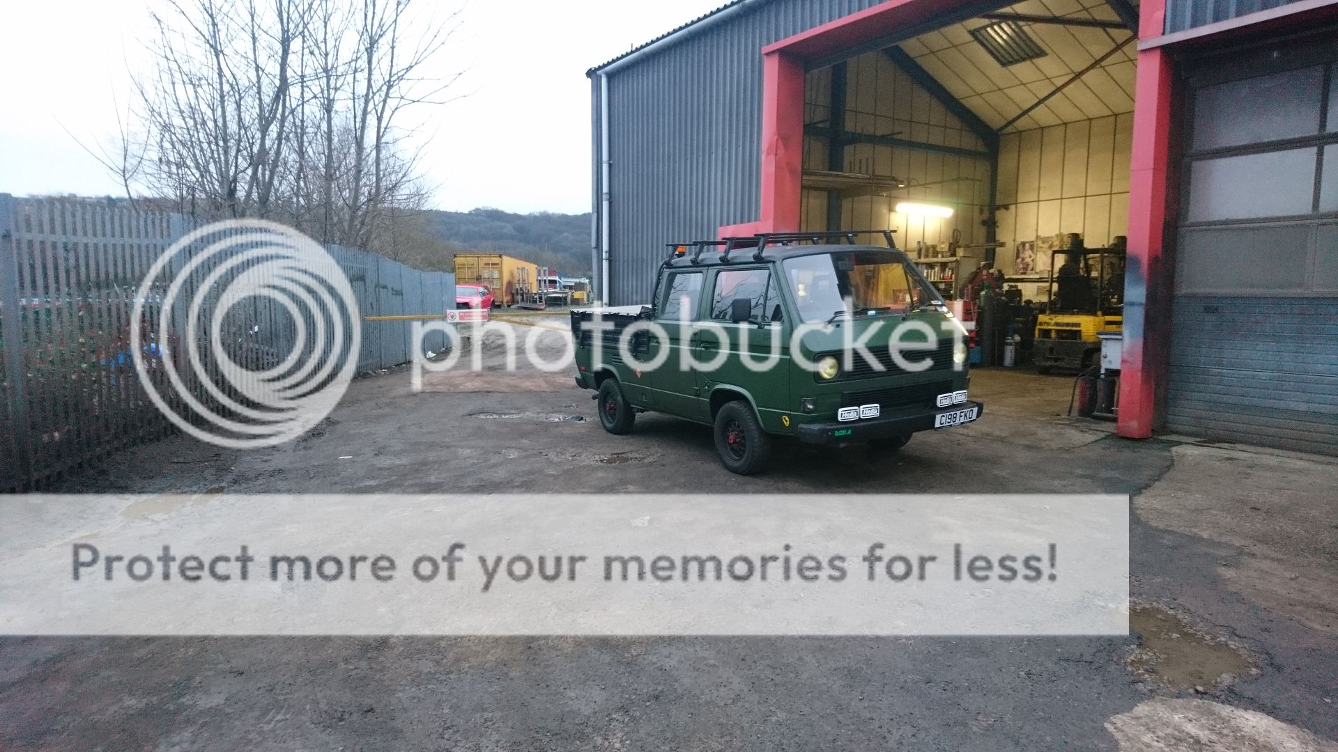

It doesn't look like it needs that much doing to it! LOL
Don't start what you can't finish!

Posted By: Lits
Date Posted: 11 Oct 10 at 21:51
Did a bit on van over weekend. Decided to do both rear wheel arches the off side one was beyond repair once i 'd ground through the "surface rust" LOL. The near side didn't appear to be as bad till i realised most of it was filler and fibreglass Cry.
So got replacement arches for both.
Roughly cut off old arch
After further grinding/cutting I was left with this hole! The corrosion caused by dirt and water building up that made its way down air vent and had not been cleaned out. Thumbs Down
There was quite a bit of dirt and also something I didn't expect! LOL
I cleaned out all I could and made patches for holes, before welding in new arch.
New arch in Smile  Couple of dents that need a skim of filler on where I had to persuade panel in.
Not a perfect fit but when it cost less than £30 not bad at all.
Big smile

Date Posted: 28 Oct 10 at 22:17
Not had a lot of time to work on the doka thought I'd sort bumpers as a small inbetween task, only a couple of rusty patches to sand and treat.
Not sure what colour to paint bumpers (or the T3 Wink)
Locker catch mounting not in good condition so rather than patch it, thought I' d grind it off and make another one. Confused
Previously been patched, too rusty to save.
Its not going to be quite as easy as I originally thought Cry some more cutting and bending required.  The factory mounts are quite "contoured" at least the one on the drivers side is in good condition to copy from.
Hopefully I'll post some pictures of finished mount when it's done.

Posted By: Lits
Date Posted: 17 May 11 at 22:04
Haven't put anything on for a while Embarrassed
Last post was about the locker catch mount, i fabricated one but it looked shit so a bungee is
keeping it shut till i come up with a better idea Confused
I ve nearly had it for a year and its still a million miles off but still using it to get to and from work
and picking my son up, he loves going in it Big smile
Thought i'd do something with pick up bed, been repaired at front before but needed doing again.
Before the butchering!
Didn't have a spot weld drill but because ofthe size of the repair spot welds i don't think it would have helped!
Trusty grinder saved me again
Got a bit bored of grinding but interest of what was underneath kept me going LOL
All cross members in good condition, except the one that the front panel and rear panels sat on
3rd one from cab well and truly fooked!
needs new piece making, ordered some 40 x 40 x 2.5 box today.
(thinking about widening engine hatch, never know when you might need to drop something else in) Wink
All ready for cross member repairs and rust removal of seams from the inside Big smile

Posted By: Lits
Date Posted: 13 Jul 11 at 21:38
MOT Tomorrow Ermm
Adjusted hand brake before work and fitted front wheel bearings to both sides after!
Both were advisories last year! Embarrassed
Posted By: Lits
Date Posted: 15 Jul 11 at 22:36
Passed MOT  Big smile
Only 2 advisories, slightly corroded N/S/R brake pipe, and rear wheel slight binding
(over enthusiastic hand brake adjustment)
well pleased  Approve  can carry on with load bed and my continual battle with the rust!
Posted By: Lits
Date Posted: 17 Jul 11 at 21:18
I borrowed brake flaring tool "just in case" before mot and thought i might as well do advised n/s/r
brake pipe, i still had some rear stainless brake hoses from the kit which i used the fronts on last
years mot. For a change all went well so i decided to do other rear pipe and hose.
There was even someone in at work to give me a bleed! saved me spraying brake fluid around the
inside of the van with my newly purchased ebay Eezibleed bleeding kit. Embarrassed
I didn't take any pictures of doing the front bearings all fairly straight forward no real dramas,
I used the mig to get the casings out don't know if anyone else uses this idea:
If you carefully run weld round casing it contracts it, they then just tap out really easily.
(I might be posting something obvious here but its something i ve done at work a few times) Smile

Now I had all the bits/bolts etc to attach adaptor plate to gearbox, bellhousing to adaptor plate and engine to bellhousing I decided to go for taking engine out of doka. I knew it wouldn't be done in just a couple of days like when using all diesel bits because I'd have to fabricate some kind of mounts to allow for upright engine. And there is always some unforseen problems.
Old 1.9 DG
It wasn't bad at all disconnecting pipes, wiring and mounts. Only one bolt seized on engine mounting bar. Smile I did butcher the exhaust a bit but it was in a bad way.
One hot tip is Jack T3 up high enough to get engine out easily.
Ha Ha there was no going back at this point! Ermm
Posted By: Lits
Date Posted: 16 Nov 14 at 21:16
Next I stripped engine from the gearbox, drained all the gearbox oil and cleaned up the casing a bit.
Then I offered the adaptor plate to the gearbox and located it on the dowels.
I made some locating dowels for the rotated bellhousing out of some 12mm bolts turned down.
I used a new gasket and the m8 vee head bolts to bolt plate on. (I did use a couple of hex heads where bellhousing didn't cover).
The bellhousing bolted up ok too, I used a new gasket on this side aswell. Before fitting the bellhousing I put a new shaft seal in.
In theory this now means the engine will bolt up at 15 degrees.
